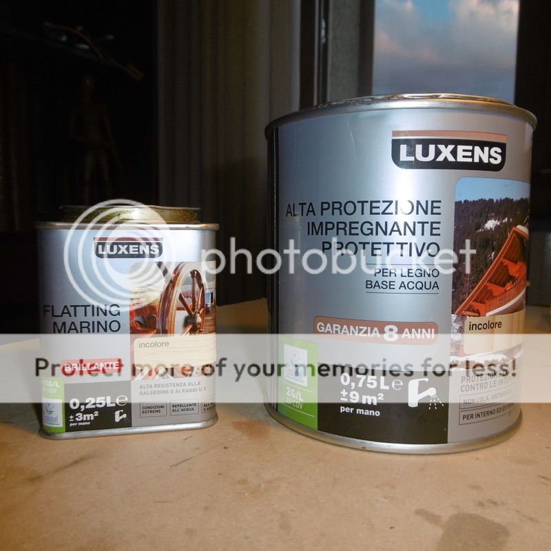

gamma schrieb:
...on Maybellene i used only water based laquers or varnishes...
Sergio, which laquers did you use? Italian brands?
Baubericht "Floh's BB" 27 Apr 2016 17:42 #267
personally I use acrylic varnish of the brand V33
Baubericht "Floh's BB" 27 Apr 2016 19:12 #268
  • gamma
  • Dank erhalten: 168
Ciao Jo, i have used two products by LUXENS, a french brand: the first product is for impregnating the wood, for filling the grain, i used 9 layers, 25% (3 coats), 50% ( 3 coats), 75% (3 coats), the second product, called "gloss marine flatting" is for final coats, again 9 coats, 25%, 50%, 75%...i started to send after the first 3coats, sandpaper n. 400; the final 3 coats were sanded by a metal sponge, grade 4 stars, used by cabinet makers, this makes the gloss finish a sort of glossy- satin finish, this is not an aquarama for being high glossy surface, a satin finish, still rather glossy, I suppose looks more realistic,.watch my pics.
These two products are very easy to brush, the surface, when dry , has no evidence of brush...it looks like an airbrushed coat and also when you do not diluite the laquer it is very easy to brush. Both products are UV protective.
I am very happy so far...

"Alta Protezione impregnante protettivo / per legno base aqua" ... I think there are some mistakes in the french language. :)
Thanks for the information. Always interesting to learn what others use. :shakehands:
