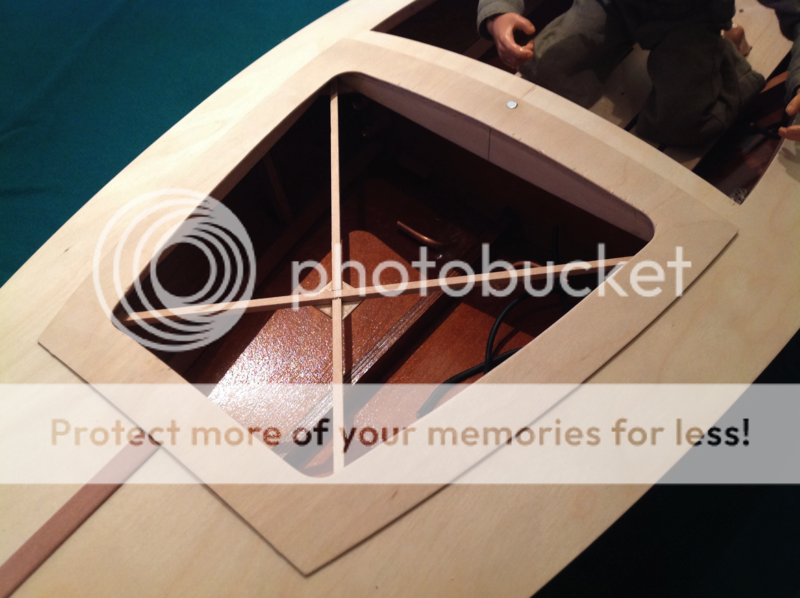

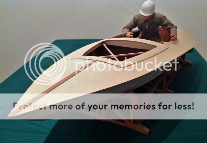

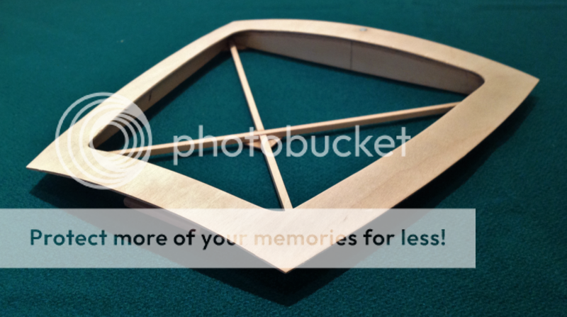

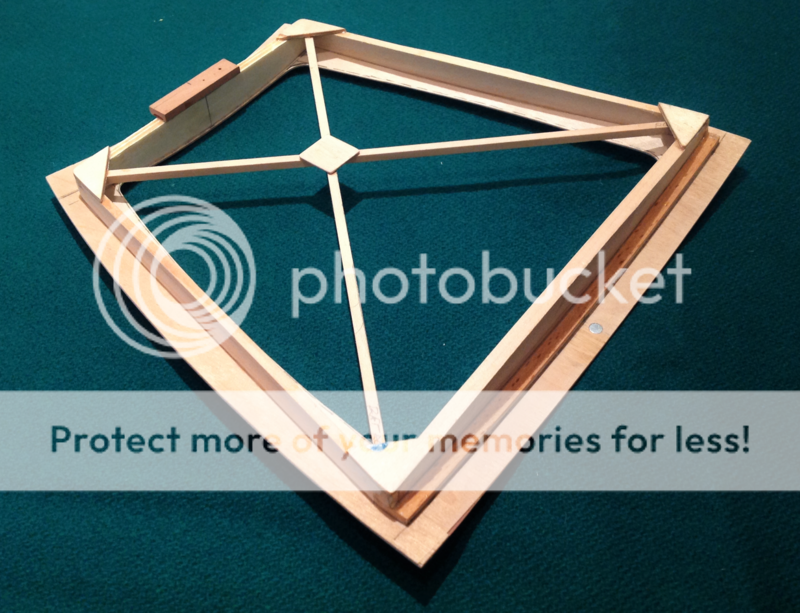

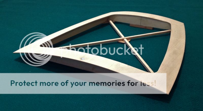

GAMMA SHIPYARD, UPDATE N. 6 Hi all, lovely 152VO boaters :winken:
This time i want to show you the cover i have built for the technical compartment and the fastening solution I have chosen which, so far, seems to be reliable but, of course, needs to be tested on the water. we will see
At the moment i can say that it is kept in place bytwo magnets, 5 mm diameter, made in China; sorry i cannot say their force in grams, the only info I got from seller was "very strong" :lesen: and they are strong, actually: only one couple of them look more than enough to keep in place the cover.
pics show :musik1:
That's all folks, hope you like, see you soon, ciao :winken:

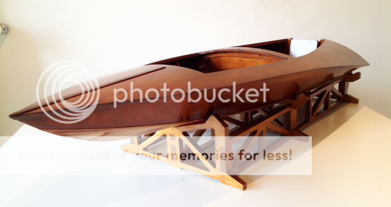

GAMMA SHIPYARD, UPDATE N. 7
Hi all, lovely 152VO boaters, i have completed the lacquering of the hull where the wood is visible, deck and sides then; the bottom (keel) will be coloured in a next step.
This is a thread written in real time so all the time since my last post was necessary to achieve a smooth, shining finish, about 15 layers of laquer, most of them 50% diluited, i have never used the lacquer at an higher concentration.
I used a water based polyuretane lacquer, made in France by "Luxens" and specially developed for marine applications, no stinky vapours, very easy to brush on, absolutely no signs of brush are visible on the dry surface; complete drying time:24 hours but after few minutes it can be even touched, it looks great...so far, :feile:
We will see how it works later on the water.
Let's start with the pics then, hope you like them
