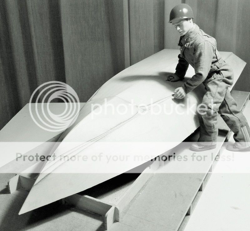

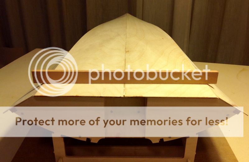

Hi all, lovely people, lately works were not as fast as expected and this because I am having a nasty pneumonia which is keeping me at home... :-o
Anyway, the planking is completed, the boat has been removed by the building trestle and finally i could watch the interior.
It is evident that the sanding was too strong :kopf3:
The evidence is shown by those brown lines on both sides of the bottom but I still hope that the final dark staining and, maybe, some additional trick will hide the most of this unwanted effect; in any case i learnt that probably I need a better light on my working desk or may be only a new pair of glasses. :kratz:

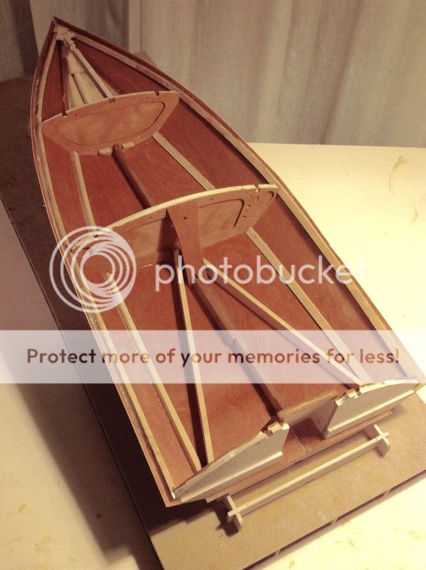

ok pic show again
It is time to start fixing the two deck stringers
Now I need your HELP, in particular i have TWO QUESTIONS:
1) I have read different points of view about the overhangs, I mean those two winglets on both sides of the rear hull, whick keep dry the rear sides: if I have well understood, they are effective on real boats but the same is not evident in our scale models; what do you suggest: to add them or not to my BB?
2) I also remember that somewhere, here in our site, there is a building tutorial about the way to make them (stringers 3 X 3?) but i am not able to find it again, does anybody of you remember where it is?
Thank you for your help

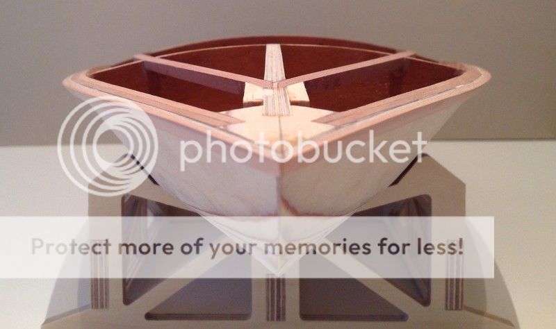

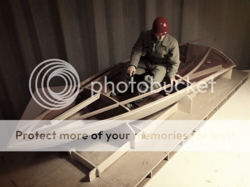

GAMMA SHIPYARD, UPDATE N. 5
Hi all, lovely people, this is, again, an update about my Maybellene, I'm still trapped at home waiting for my pneumonia being over; anyway, little by little, step by step, works went on.
Hopefully, the most of sanding and filling my room with dust, not so good for my lungs in this moment, has been completed, at least for now.
Pics now: :dance:
this is were i am to day, next step the sealing of the interiors compartments; I have decided to give a flat finish to the interior area , external upper surfaces and hull sides will have a satin or glossy finish, still to decide; the bottom of the hull will be covered by fiberglass cloth, the lightest i can find, and then painted to hide those unwanted brown lines.
that's all folks, hope you like and thank you for reading, have a nice day.
See u soon :winken:
Sergio
Maybellene: an italian BB 06 Okt 2015 09:36 #29
  • Schubrakete
  • Beiträge: 499
  • Dank erhalten: 132
:1st: :1st: :1st:
Maybellene: an italian BB 06 Okt 2015 10:02 #30
:top: :verknallt:
Funny, the sanding grain on the bow looks like a smile .. ! ;)
