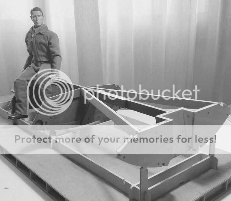

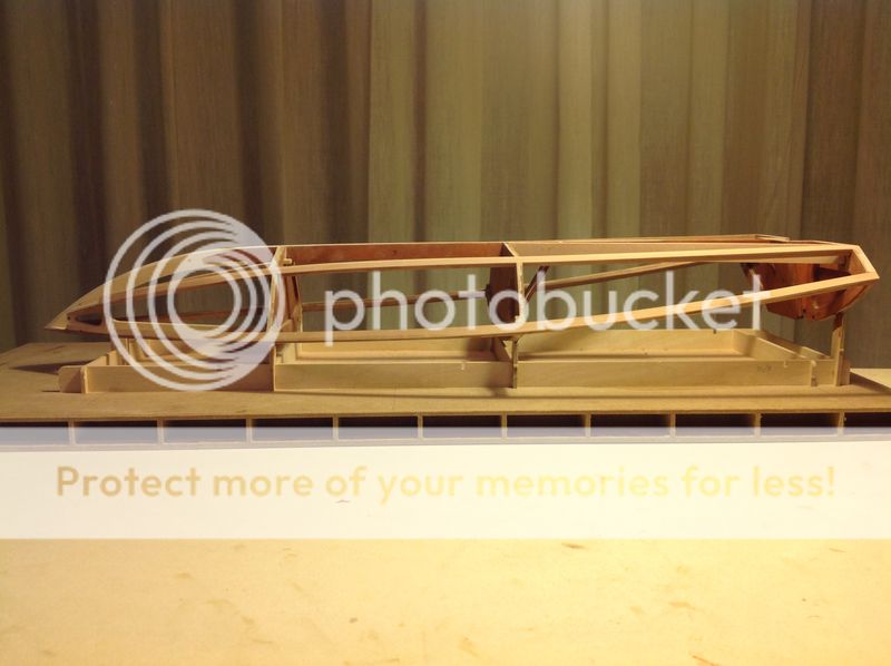

Ok, and here we go with the pic...this is where i am at the moment, after few days of work ( i am a slow worker... :oops:

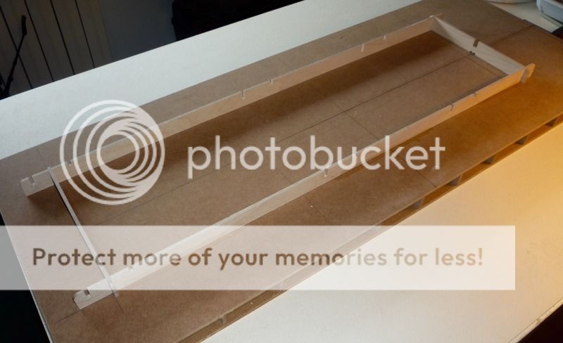

first of all the building struts glued to a thick but light MDF base board

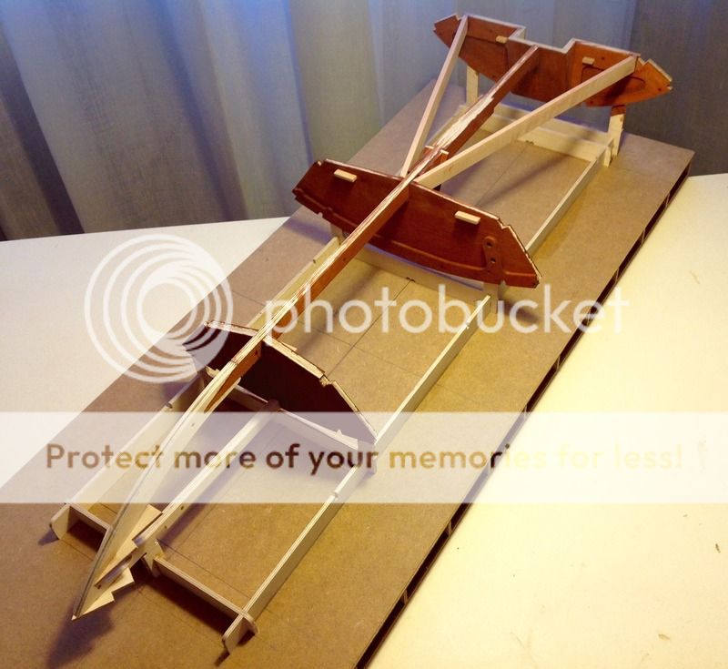

then i detached all the required parts from the wooden frame and glued them together...i preferred to stain parts after they were glued, of course it was a risk but with a little patience results, so far, are acceptable; i use 2 components epoxy glue, UHU PLUS endfest slow drying (12 hours)...yes, it takes a long time to set but i can work relaxed: planty of time to fill and smoke my pipe, drink a cup of coffee and reply to the usual disturbing phone call. :mrgreen:
Parts were inserted and glued to the baseboard, it is really a rock hard structure, time for the builder to watch the results and have some rest
I forgot to say something about the colour i have chosen for the wood; for sure i like those light oak BBs but i am afraid that any fault, even the minor one, will be enphasized and more visible so...i will have a darkish BB., as you can see...not too bad.
A this's all folks, this is where i am at the presentm, slow worker i know but...I told you, be patient...next step...side bars.

GAMMA SHIPYARD: UPDATE 2

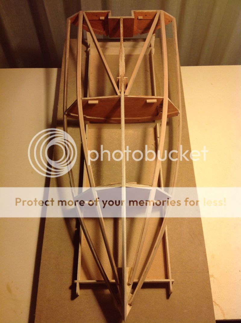

Hi all, lovely people...the second step of my project has been completed: the stringers have been glued to the frames, bent and sanded to shape; i followed the instructions and the process was not so difficult....only a couple of minutes of pure panic :bibber:
Results, so far, look acceptable, at least to me :mrgreen: but better you see them directly so, stop talking and let's go directly to the pics:
The first two stringers are in place :freu1:

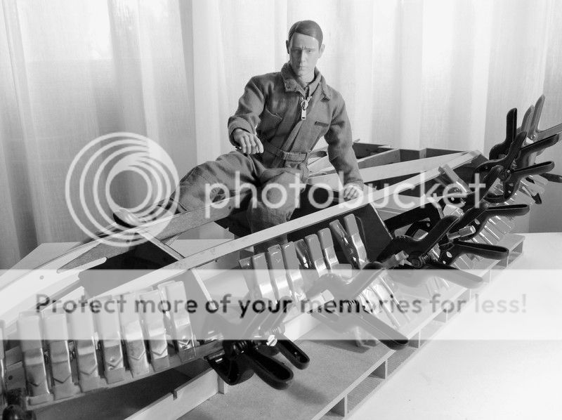

to add the additional, external stringers the usual orgy of clamps was necessary; TIP FOR FUTURE BUILDERS: do not even try to start the building if you have not ready an HUGE AMOUNT of clamps, small, medium and large size; they are a must for a good and safe building :vortrag:
and here we are, after a long, slow, dusty sanding session the Maybellene is taking shape and it is absolutely beautiful :feile: :verknallt:
and again time to relax and watch the work...
This is where i am, next step : hull planking, since that moment, have the best time!! :bier:
see u soon, ciao :winken:
