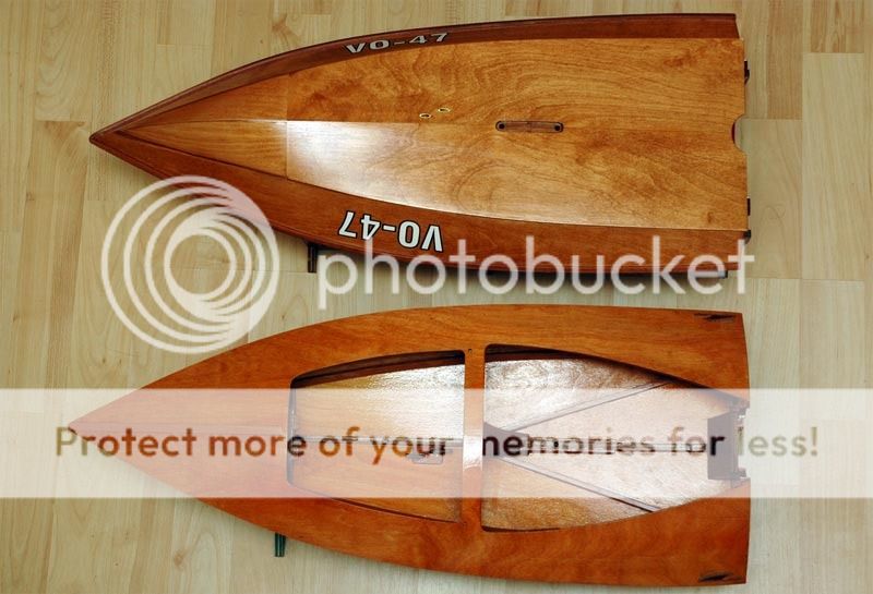

Da Hostarea den Dienst eingestellt hat, hier nochmal das zugehörige Foto aus dem BB-Baubericht:
@Sergio:
Don't worry, the position of the water inlet / outlet is practice tested and works 100% reliable. After each ride the heat sink of my ESC is completely flooded with water, without any air bubbles in the water supply hoses.

Thank you Jo, your words make me more confident and this beautiful VO 47 makes me envious : great finishing, grat colours, great details :top:
Maybellene: an italian BB 14 Jan 2016 19:48 #64
gamma schrieb:
... and this beautiful VO 47 makes me invious
Thanks, Sergio. The two boats in the picture above are from the pilot production (pre-series test run): my VO-47 at the top and Lilli's VO-46 at the bottom. The kits of the series production got several further improvements: better wood (6 layers tegofilm ply instead of 3 layers normal ply), optimized clearances (respecting the layer thickness of the glue and the lacquer coats), etc.
That's the drawback of my job: I for myself take the non-optimized pre-series stuff... and the others get the high-qrade series products. :pfeif:
Die beiden Boote im Foto oben sind aus der Nullserie (Vorserien-Testlauf): meine VO-47 oben und Lilli's VO-46 darunter. Die Kits der Serienproduktion wurden noch weiter verbessert: besseres Holz (6-schichtiges Tegofilm-Sperrholz statt normalem 3-schichtigen), optimierte Spaltmaße (unter Berücksichtigung der Schichtdicke des Weißleims und der Lackschichten), etc.

Thank you Jo, for your reply, now a further question: have you ever considered the possibility/opportunity to offer also a " luxury " edition of BB (higher price of course) with high quality wood...let's say mahogany? Just an idea crossing my mind
